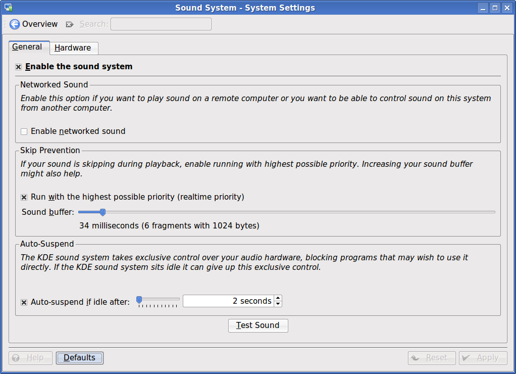

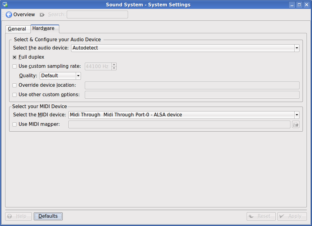

    I just tested, I can play amaarok and on top of that sound from firefox (youtube). We'll figure it out. Are you using alsa ? (I am).
    I attach a couple screenshots of my sound settings (in System Settings).
    Hope this helps, please let us know!
      Re: Problem with KDE sound system
      I checked your settings with mine and the only differences are that my Sound buffer is much longer (232 millisec, it was like that), that the auto-suspend delay is 0 seconds (I changed it from 2 to 0 hoping it would help) and that "Full duplex" isn't checked. I'm not sure what that does but checking it doesn't seem to help (unless maybe if you have to reboot first).
      I am using the same ALSA MIDI device as you are.
        full duplex is needed for skype for instance, it allows to "record and play at the same type" (you can write click on the options and see a context help). I am not sure if it allows also two sound applications to be mixed at the same time ...
          I turned it on but it still doesn't work...
