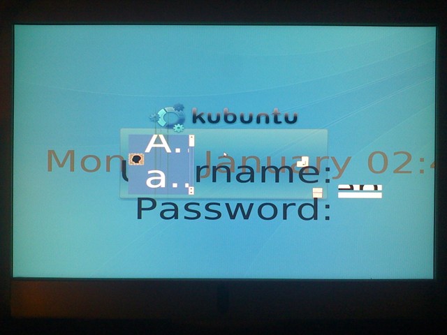

    Hello!
    I installed kubuntu gutsy - clean install, but I kept my /home intact, because the upgrade didn't work - and now the kdm login screen is oversized. I tried reinstalling kdm with apt-get install --reinstall kdm, tried dpkg-reconfigure - nothing worked. It looks like this:
    [img width=400 height=300]http://lh6.google.com/CsabaMolnar/RxoLfhIJxFI/AAAAAAAAAFE/D4bTTfxBbGo/kdm.jpg?imgmax=512[/img]
    Since then, I narrowed the problem down to the new intel driver. With my old xorg.conf it works (it uses the i810 driver, but without the i915resolution package, it only displays in 1024x768 instead of 1280x800). Using the old driver (I have an integrated 945 card) with the i915resolution package would probably work, but I'd rather have a proper solution...

                        Ok, I found the solution. I knew that something happins right when X is started, so I looked at the options passed to X in kdmrc (after a finally realized where they can be found). The default is this:
                        [X-:*-Core]
                        AllowNullPasswd=true
                        AllowShutdown=All
                        NoPassEnable=false
                        NoPassUsers=
                        ServerArgsLocal=-nolisten tcp
                        ServerCmd=/usr/bin/X -br
                        (to be clear - this is in /etc/kde3/kdm/kdmrc)
                        It was obvious that the login screen wasn't any standard size (it's not like it was set to anything sane like 640x480) - so it dawned on me that it might be that the new driver misdetects the dpi - and surely enough, after changing the ServerCMD line to
                        ServerCmd=/usr/bin/X -br -dpi 100
                        , the problem went away.
                          While this does not change my login screen, by using dpi 72, I got a much better balance in my normal 1600x1200 resolution.
                          So, thank you - and I will go back to reading other details in this file.

                              OMG! THANK YOU! THANK YOU! THANK YOU! And so simple - it doesn't make sense.
                              I've been through 4 computers, 2 HDTVs, 2 versions of 2 distributions (Suse and Kubuntu), probably hundreds of xorg.conf's, and many forums over the past 6 months or so. I've been told I'm a n00b, I've been told I'm too old, and I've been told simply not to enable 3D acceleration because I have f'ed up hardware. (The hardware is fine.) For me, everything always worked great in KDE until I enabled the proprietary Nvidia driver - then boom - No KDE, No Gnome. About the only thing that worked was the Framebuffer and XFCE. I wonder if I would have had the same problem using gdm or xdm - but I was looking in the wrong place, namely xorg.conf.
                              And what fixes the problem is telling KDM to use 100 DPI fonts. How crazy is that?
                              I am attaching a pic for posterity.
