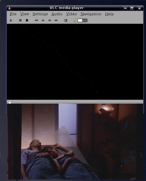

    I have 2 separate problems, though they may be related.
    If I play ANY video file with VLC, The video playback is very choppy, and the video itself has an offset downwards.

        Re: Video playback problems
        I had choppy playback in VLC too after upgrade to Gutsy. Preferences > Video > Output Modules (Advanced options) > Select 'X11 video output' solved it for me.
