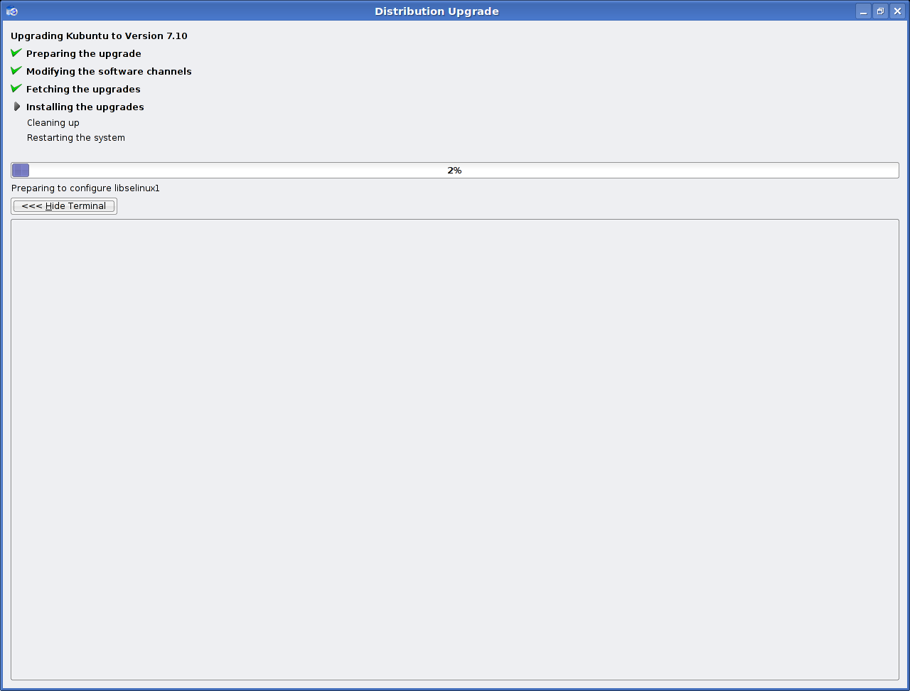

          I also had a terrible upgrade (I could never have a clean upgrade in Kubuntu). I think it has to do with 3d party packages, I have quite a few. I ended up upgrading manually.
          Anyway, I can think of two ways you can try to resume:
          • Open Adept again: do you still see the "version upgrade" button ?
          • Do you see the "updates" applet showing updates on the panel ? (Kicker). In one of my attempts, I opened it, and it showed a button for the version upgrade.
          In my case, Adept segfaulted at some point (see the screenshots - the second is the place where I got stuck after the seg-fault). Upgrading from Synaptic was a mess because many packages ask for confirmation. I ended up dropping to the command line
          apt-get upgrade -y --ignore-hold
          On the bright side, after the upgrade, everything is working great. Boot time is noticeable faster. 40 secs to the login screen in a modest Windows XP oc'ed to 2600+
