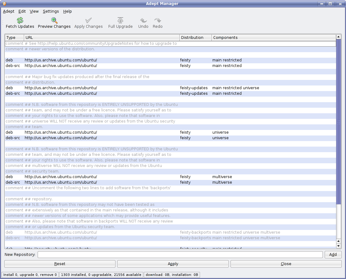

    The instructions say to open Adept Manager, click on Manage Repositories, and get this dialog box:
    http://kubuntu.org/~jriddell/kubuntu.../snapshot2.png
    Nope - not there. Instead, I get a list of repositories. I have attached a window capture. The "Full Upgrade" button is grayed out, and I see no way to follow steps 2 - 5 in the upgrade instructions:
    https://help.ubuntu.com/community/Gu...040bf791c42f52
    Any help would be appreciated.

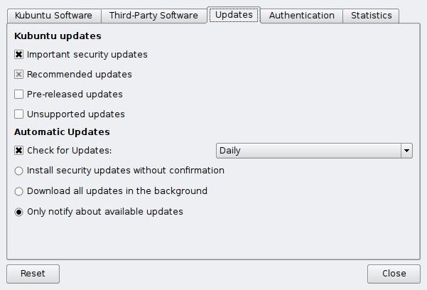

        Then you should be able to do as the instructions say. When you have Adept Manager open and you click on Adept | Manage Repositories and click on the Updates tab you don't see the following:

          That is correct - I do not see the dialog box you attached. Instead, I see the list of repositories in the window capture that I attached in this thread's root comment.
          I suppose one workaround might be if someone would post the URLs for the pre-release and recommended updates repositories and I could just add them in manually. However, I'm curious as to why adept manager isn't behaving as expected. It might have been helpful if there were documentation for adept-manager.

            That's very intriguing, as the snapshot you posted appears to be what Adept Manager running under Edgy (6.10) would show.
