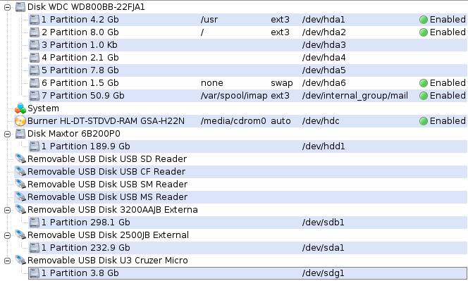

    I migrated from Fedora FC4 to Kubuntu Feisty a few months ago. All went well, including mounting the LVMs that I had set up under FC4 - it took some research, but they're all accounted for and the CLI tools work fine.
    The Disk Manager GUI, however, refuses to recognize LVMs. See attached JPG. I suppose I should have (found and) downloaded an LVM-Aware GUI, but (a) where from (b) why?
    Just in case this were to be an unexpected item, you'll find below the df / pvdisplay / lvdisplay /blkid results.
    This is a small nit for a system that otherwise is a pleasure to use!
    Cheers,
    Michel
