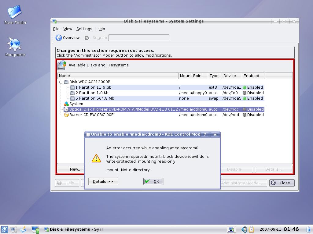

    Just did a fresh install of Kubuntu 7.04 and for some reason my dvd and cdrom drives aren't working. I put a disk in and the mount window comes up then nothing. Went to System Settings/Advanced/Drives and they were both "disabled". Tried enabling them but got the following error message in the attachment. Anyone know how to fix this? Thanks.

    Check your /etc/fstab file-cdrom is normally /dev/hdc it might be an idea to change hdd to hdc in fstab and reboot and see if it works.

      Whoa -- there's a worse problem than that! What's going to happen when you try to use that so-called "Floppy Partition" :P
      The floppy drive should indeed be /dev/fd0, mounted at /media/floppy, but that should not appear anywhere within hard drive partitions.

        I should have looked at your pic a bit longer. The devices /dev/hdc & hdd look ok but linux appears to have a problem with your dvd as it gives a write protected error. That's obviously no good. Also, the floppy should not be a partition.
        You had better print out the file /etc/fstab and put that on here so we can look at it.

          Mounting read-only is fine, it's a read-only medium.
          In addition to posting /etc/fstab, how about the output of "ls -l /media/cdrom0"?
