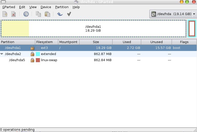

    I'm running Kubuntu on an old Micron P3 with a small 20gig HDD. When I installed Kubuntu it took over most of the drive with a small swap and extended partition. How would I use Gparted to take say 10 gigs away from hda1 ext3 and create a backup ext 3 partition. I'd like to make backups of Kubuntu using Mondo or Ghost. Thanks.

      You can't repartition a drive that's currently in use, and the drive you're booting from will always be in use. Get the LiveCD and use that.

          There were some people with problems with Gparted LiveCD, like me and I think I have 0.3.4-7: it hangs booting as it couldn't recognise my CD drive. I used Knoppix LiveCD instead as that works fine on my system and has Gparted as one of its programs.
