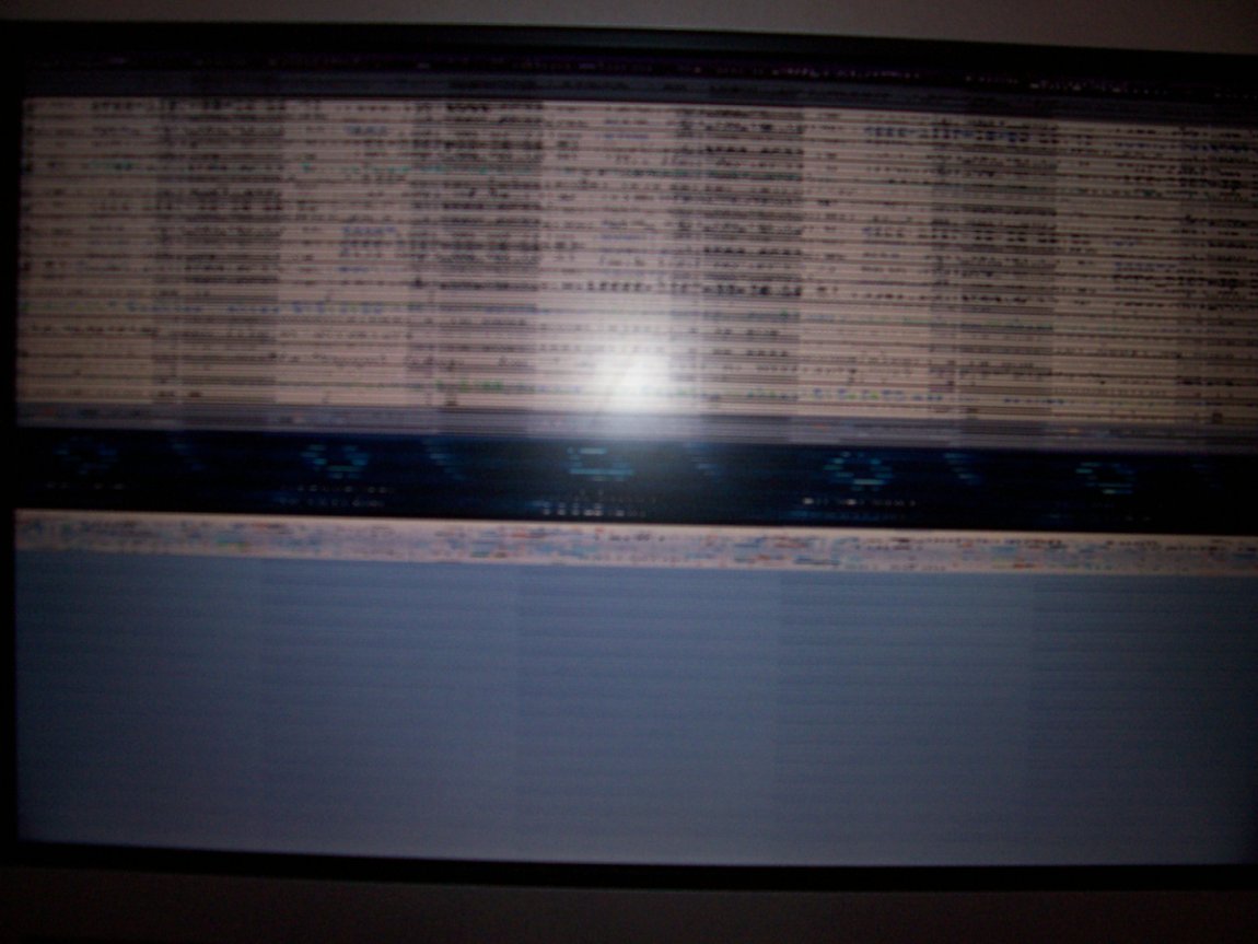

    I'm having a problem with my screen/graphics. When I start my computer I can see the kubuntu logo fine, but when I get to the login screen only half the screen appears to be being used and there seem to be about 5 copies of it superimposed, out of phase, on one another. If I log in the splash screen and everything after this appears in this way too.

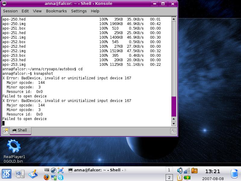

        After a bit of a blind struggle, I took a screenshot with ksnapshot back in Feisty Fawn and sent it to a working computer. The screen shot is a slightly smaller than usual, but perfectly readable, image of the desktop. I also took a photo with a digital camera of the totally unintelligible screen mess that I actually see for you to compare - everything is squished into the top half and superimposed all over itself.
        First what I see:

          And here's what the computer sees:
