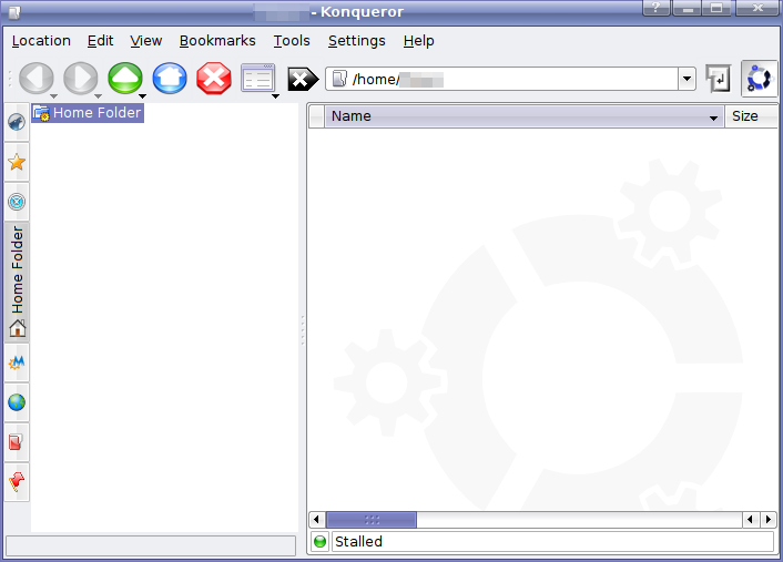

    I have mounted on my system a Maxtor 300GB network drive where I keep my music, movies, etc, and when I go to access a lot of data, like a huge playlist or try to add two 700MB avis to VLC, all of the programs using the share hang and I am forced to terminate. When I go to access the mounted directory (in my home) the icon of the gear is turning and never releases. I end up having to reset the computer manually to get it working again.

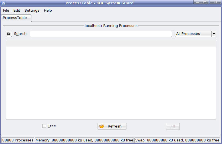

    Also, if the process manager loads, none of the processes are listed, and in the status bar all of the number values are 8's.

    Here are some screenshots of the behaviour I mentioned above.
