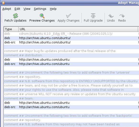

    What I get when I go to the "Manage Repositories" screen is a GUI view of the text of my /etc/apt/sources.list with no buttons or any other cute screen with checkmarks like I have seen. Could this be because I edited my sources.list by hand? I have tried to restore a vanilla sort of sources.list, but with no joy.
    How do I get Adept Manager to show the screen that everybody else is seeing? I don't know if I should use the "System Update Tool" under K->System since that seems to me to be simple Ubuntu? I see downloading the DVD as my only other alternative to upgrade; but this might mean something is fundamentally broken on my system?

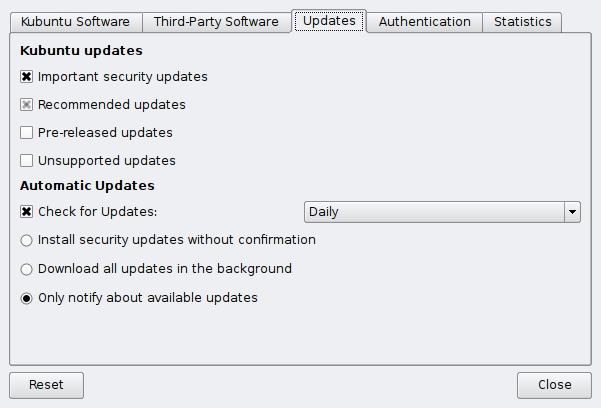

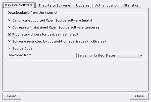

        2.1 Cruiser (KDE 3.5.6) is correct for Feisty. Hmm. You don't have the following when you click on Adept | Manage Repositories?
          Re: Can't see "Recommended Updates" button and other screens in Adept Manager
          I'll show you what I get if you tell me how you created those JPGs.
            Use KSnapshot. K Menu | Graphics | KSnapshot
            Choose 'window under cursor' to limit the image to just the item you place your mouse cursor over. The program is very simple to use. The default save to location is your home folder. Once the images are saved, you post to your message by clicking on the Additional Options... in the Post Reply. You will see the line for adding files (you click on the folder to the right of the file name field) that you select by browsing to the location on you PC.

              Here's what I get in "Manage Repositories".
                Yup, that isn't what you should be seeing. That looks a lot like what I had in Adept Manage Repositories when running Edgy. Was your system upgraded from an earlier release??
                            Originally posted by stephen_biggs
                            Any help appreciated.
                            Install package 'software-properties-kde' to get the 'new' manage repositories dialog
