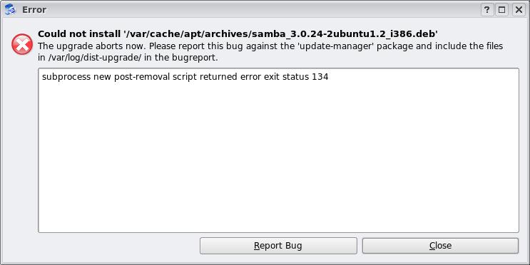

    OK, I was on Kubuntu Edgy, and followed the official guide here: http://www.ubuntu.com/getubuntu/upgrading
    The Distribution Upgrade started fine, everything was going ok...
    Then *wham*... abort. This is from the main.log..
    2007-06-26 10:16:37,077 ERROR got an error from dpkg for pkg: '/var/cache/apt/archives/samba_3.0.24-2ubuntu1.2_i386.deb': 'subprocess new post-removal script returned error exit status 134
    but according to the error I got, it is a problem with update-manager:
    (attached screenshot)
    According to the above linked guide, update-manager should be at 0.45.2, but mine is 0.59.20. I didn't have it installed before starting the upgrade, so I just did an apt-get install of it. I only used the Adept Manager, and didn't add any feisty repositories. I was following the guide, and it didn't say to do that.
    OK, so bottom line is that something is borked with my upgrade. The Distribution Upgrade window is just sitting there and is obviously not running. It is on the "Fetching and installing the upgrades" portion, and is sitting at 55%. The dpkg command is still running (according to ps -ef) but it clearly isn't doing anything.
    So.. what now? What are my options? Is there a way to recover it?

      I'll just carry on this conversation myself...
      Found several bugs listed on the Ubuntu site, seems to be a problem with update-manager... didn't really see any kind of resolution or suggested workarounds though. Seems like this has been a problem with Kubuntu upgrades for a couple of months. Here is one of the main ones I found:
      https://bugs.launchpad.net/ubuntu/+s...er/+bug/108555
      So I suppose I have to dive in...
      I killed dpkg and python. Tried to do 'aptitude dist-upgrade' (as someone suggested in one of the bugs)... it said that dpkg had been killed, and I needed to do 'dpkg --configure -a' to fix it.
      Did that, and it resumed installing packages. Crossing fingers, not sure what I am going to do when it is done... I may try to run the Upgrade again, just to be sure.
