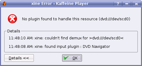

    Okay, I want to know the packages to download/install in order to have Kaffeine open and play DVDs. The basic installation of Kubuntu 7.04 (i386) does not get Kaffeine functional for DVD playback.
    I had the same problem with 6.10, and got Kaffeine working after downloading/installing the libdvdcss2, libdvdread3, and w32codecs packages.
    In order to get and install libdvdcss2 and w32codecs packages, I added the following two repositories to Adept:
    deb http://medibuntu.sos-sts.com/repo/ feisty free non-free
    deb-src http://medibuntu.sos-sts.com/repo/ feisty free non-free

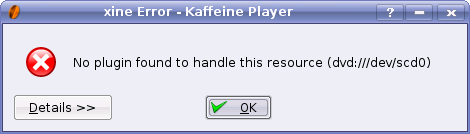

    Both packages were successfully installed. But, Kaffeine still won't open a DVD. I get the following error:
    So, exactly what packages are required in 7.04 in order to have Kaffeine open and play a DVD?
