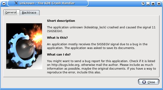

      I actually have rebooted, and every thing seems fine. I have a new error that pops up(see attached pic). But other than that it works fine.
        Re: upgrade tool failed
        "Signal 11" is not a good one ...
