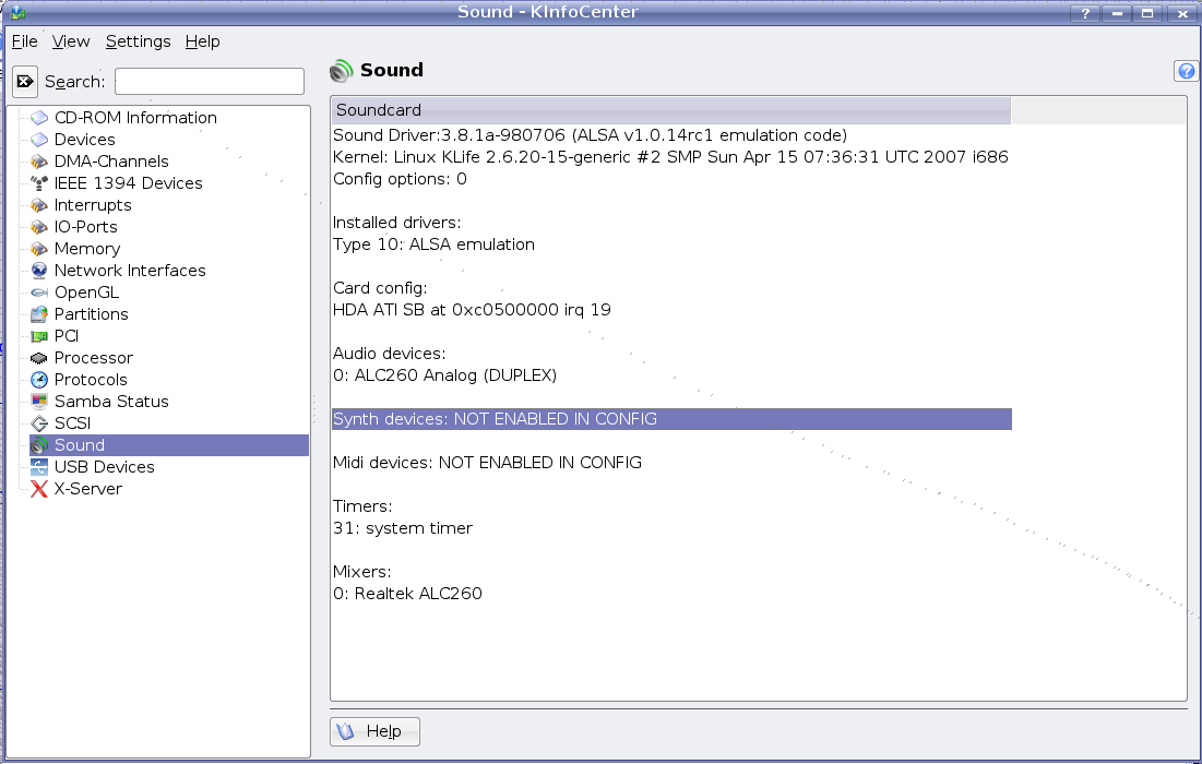

                Here is a snapshot of "KInforCenter - Sound"

                  Checking the page you mentioned, it shows Linux drivers for kernels 2.2.12 and 2.4, but the kernel you're running is probably 2.6.
                  So, unless you can find drivers elsewhere (and there don't appear to be any in the repositories), then I'm afraid you aren't going the be able to have any sound with that card.
