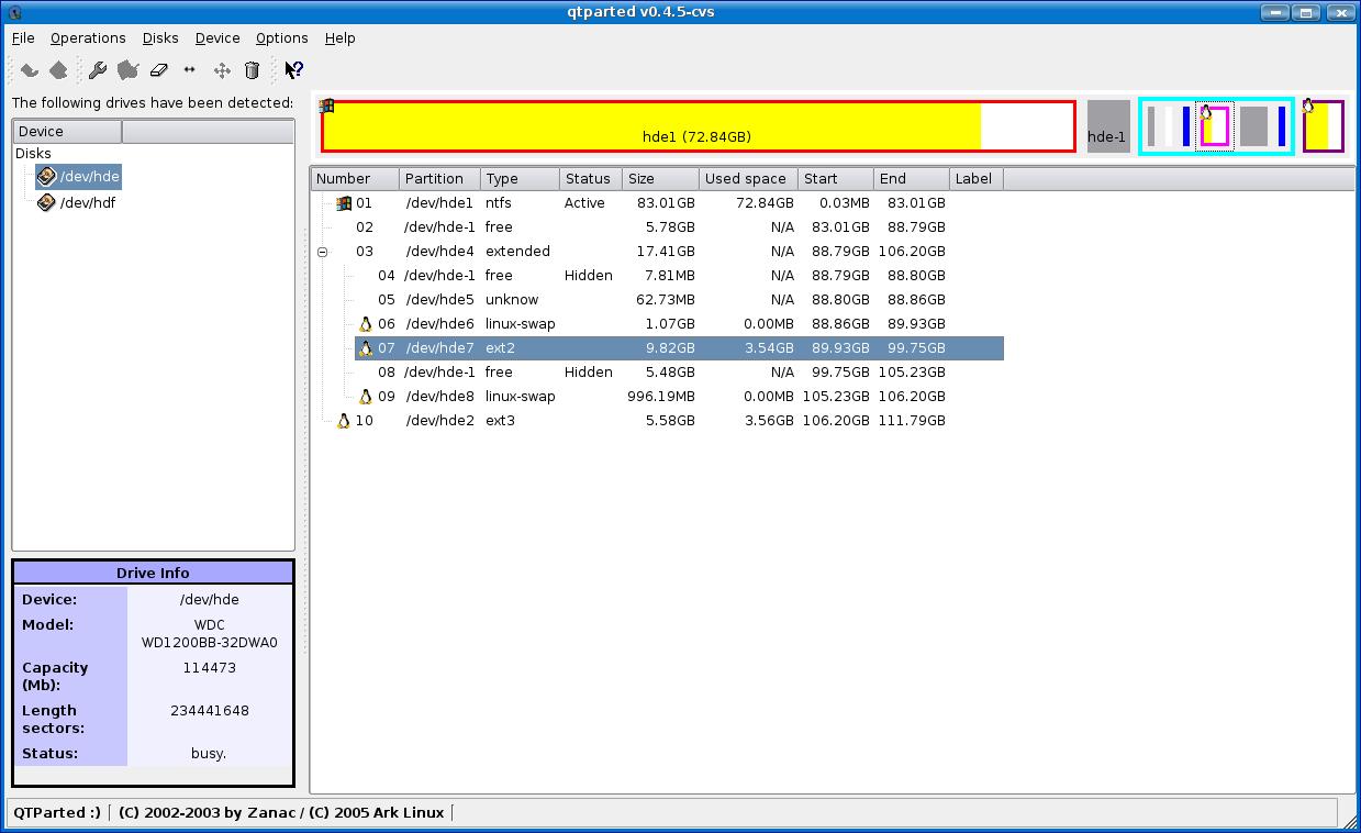

            Easiest way is to use a graphical partitioning tool. You may already have one in Windows (Partition Magic)??
            If you don't, as you can boot Kubuntu, grab QTparted or Gparted from Adept or apt-get and post a screenshot of the partition info (or just copy it out)

              Ok, here comes the screenshot. Looks like quite a mess. Probably this is because the different kubuntu installers did not recognize mandriva and set up swap and all that on its own. Thanks again...Cliowa
                Re: triple boot
                Well its pretty funky and probably not the best use of space but everything looks to be there so you should just try editing your kubuntu /boot/grub/menu.list to boot it. You need to do this with admin privileges like this from within Kubuntu

                then add the commands as in the menu.list example below: if Kubuntu is found at root (hd0,1) (for example) then I guess Mandriva is going to be found at (hd0,6), you just need to follow the same scheme. You need to know your mandriva kernel image and if you don't you'll need to either mount mandriva from within Kubuntu to find it like this from within a terminal

                  As to my formidable partitioning: Can I do anything about this mess (whithout reinstalling and setting it all up again?

                    Regarding your partitioning - If we can't find your kernel, starting again may be your best option
                      Re: triple boot
                      If it possible that hde5 was Mandriva's /boot partition? Looks about the right size.

                              Mandriva's definitely on hde7, I simply gave it some more space.
                              How would this chainloader thing (what that, anyway?) help me with my fatal partitioning? Could I do it without having to reinstall my kubuntu, which I like very much the way it is just now?
