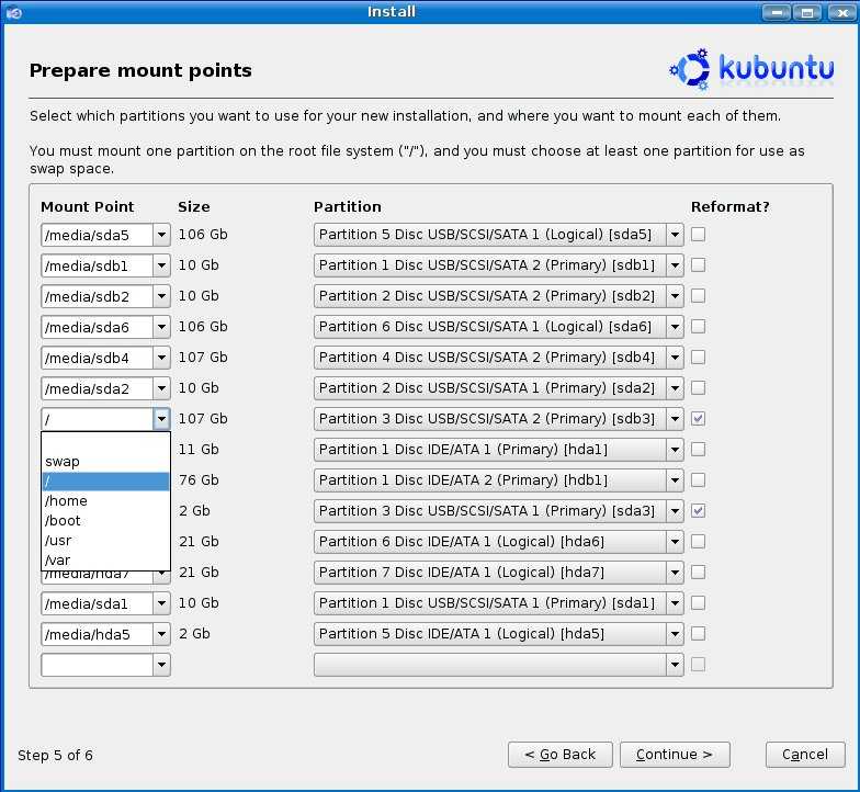

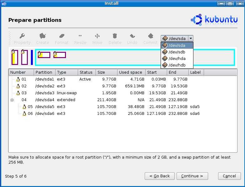

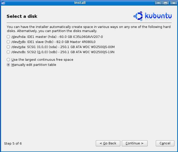

        And with the standard Kubuntu 6.06 LTS Dapper Drake: Step 5 of 6: Select a disk / Manually edit partition table => Prepare partitions => Prepare mount points...

          I am able to go till prepare partitions, but I don't see any option to go to prepare mount points.
          I have just one hdd, /dev/sda so I select them from the drop down menu and I still see the same
          page with no option to choose the mount points.

                It is there, straight after entering your time zone you need to say "manual partitioning".

                    oh, so you've got it Once you are in manual partitioning you can select a partition and click on edit. Now you can edit the mountpoint.
                      Re: specifying the partition to install to
                      "Prepare Partitions" = Partition editor.
                      If your partitons are Ok, you could simply click continue. After this Kubuntu should offer (it does here) default mount points, you can change these.
