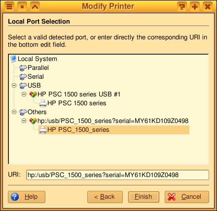

            Originally posted by footer
            Would you care to elaborate on this?  I only see PSC 1500 series when I go to install the hpijs driver ...
            Right...when installing the printer, you should get to choose which port/device to use.
            (See the screenshot)
            If you choose the hp:/usb/* -port/device you can use the command 'hp-toolbox' to monitor ink levels and a few other options.
            If you have already installed the printer you can change the port/device from Print Manager>Select your printer>Choose 'Properties' Tab>Choose 'Interface' Icon>Click 'Change'
            (You may have to click 'Admin mode' in Print Manager first)
