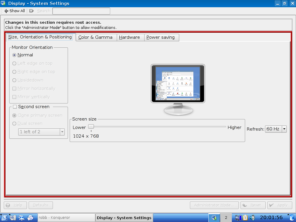

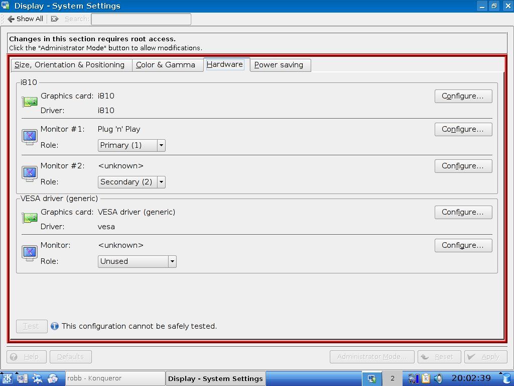

        I am also having a problem with my Latitude X1 running on a 915 graphics card. The gory details:
        - Display stuck at 1024x768 instead of 1280x768 (max res for this display)
        - Graphics Card/Driver showing as I810 instead of 915
        - Once logged on in Administrator Mode, won't let me change from 810 to 915 or set monitor #1 aspect ratio to 16:9 (apply and test buttons are not available).
        I have downloaded a linux driver for the 915 graphics card from intel, but not sure how to install it. This is my first go with linux, so any help would be good. Thanks in advance.

            Yeah, I tried this yesterday. The xorg.conf file already had the following settings:
            Section "Device"
            Identifier "Intel Corporation Mobile 915GM/GMS/910GML Express Graphics Controller"
            Driver "i810"
            BusID "PCI:0:2:0"
            EndSection
            Section "Monitor"
            Identifier "Generic Monitor"
            Option "DPMS"
            EndSection
            Section "Screen"
            Identifier "Default Screen"
            Device "Intel Corporation Mobile 915GM/GMS/910GML Express Graphics Controller"
            Monitor "Generic Monitor"
            DefaultDepth 24
            SubSection "Display"
            Depth 1
            Modes "1280x768"
            EndSubSection
            Depth 4
            Modes "1280x768"
            EndSubSection
            Depth 8
            Modes "1280x768"
            EndSubSection
            Depth 15
            Modes "1280x768"
            EndSubSection
            Depth 16
            Modes "1280x768"
            EndSubSection
            Depth 24
            Modes "1280x768"
            EndSubSection
            EndSection
            It is supposed to be running at 1280x768, but I'm still limited to 1024. I still can't change any of the settings thru the hardware gui (see attached snapshots). Thanks for the reply, but I'm still lost.
