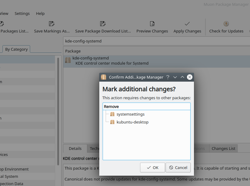

      Yes, what you mentioned before was my first thought(as it worked then as you said), and tried it while back, very soon just after I installed 20.10.
      But was surprised when it crippled KDE Plasma, and so from command line got it undone immediately.
      Trying to install that even now would do the same. Please attachment from just now.

        Ok, so you can't install kde-config-systemd in 20.10, but this third party tool does not appear to have been updated in a while so maybe that is a good thing.
