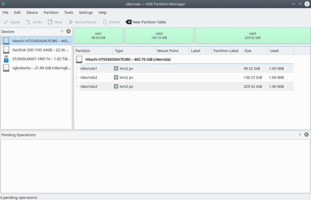

      Yes,you are right, I did not mount them, I cannot use the 'mount' option, it is grayed.
      And no, I did not assign any filesystem to any partition, I do not know if it can be done or should be done...

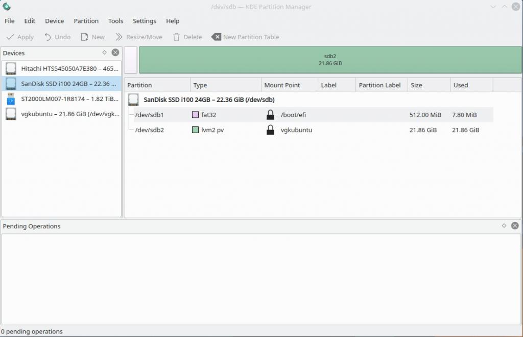

      Kubuntu did assign a fat32 to the /boot/efi partition, but left the rest as lvm2 in my 24GB SSD drive:
