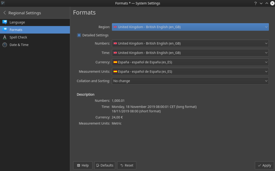

              I had the opposite
              Everything in English, time and other things in Spanish.
              I tweaked it here:

                I had the opposite
                I tweaked it here:
                [ATTACH=CONFIG]8383[/ATTACH]
                Yes
                I was have uncheck Detailed Settings, I check and set all for Spain.
                Restart computer some times and sleep computer, now, Thunderbird appears always in spanish, issue solved
