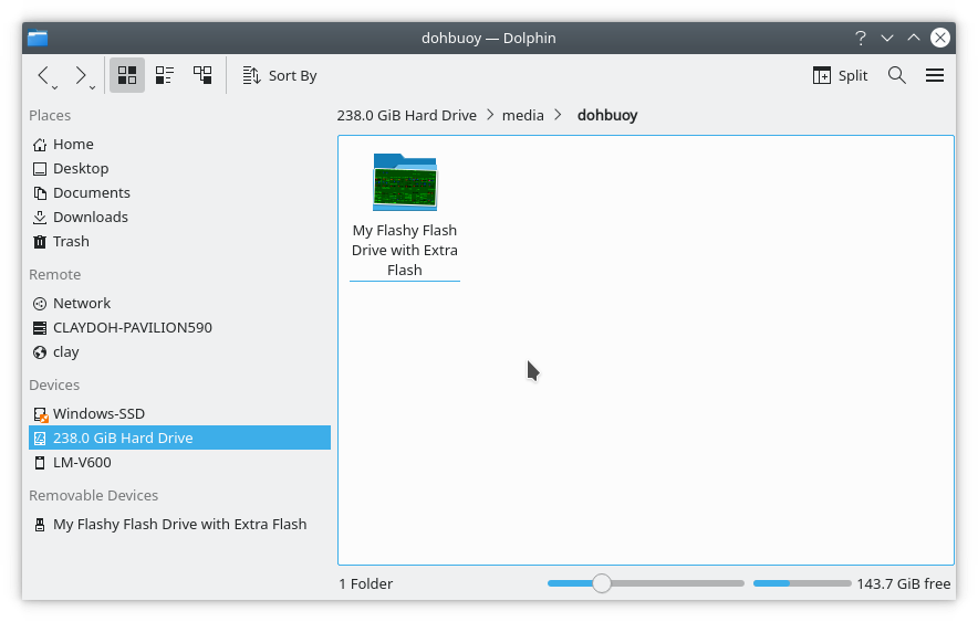

    I normally give the partition of the drive a label, right click on the partition in Partition Manager and go to Properties. You'll need to unmount it first I believe, via the same right-click menu.
    Then my removable stick shows up the way I want it to,

      Thanks, @claydoh. I'll give that a try when I'm back at the laptop.
        Well, you can "label" the filesystems. Then when they mount they label is displayed in Dolphin.
          If they're EXT4 (3, whatever - not FAT) you can
          sudo e2label /dev/sdxx Transcend_Blue
          df -h will tell you what the xxs are.
          They don't have to be unmounted.
