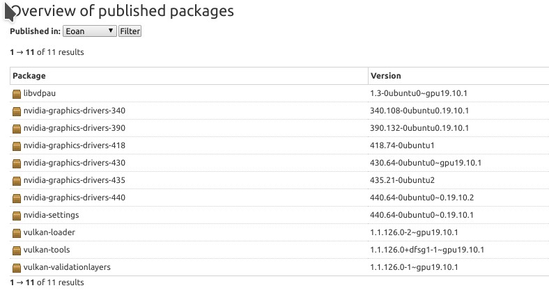

    I believe there is another repo that has more updated packages than the main ubuntu ones. I just forgot where it lives.
    I found it: https://launchpad.net/~graphics-driv...ive/ubuntu/ppa Unfortunately they don't have all the 440 packages in the repo yet. The best I could get was the 435.21 driver.

        That is weird. On my system, the same repo only goes up to NVIDIA 435 It doesn't show any of 440. How can this be since we are accessing the same repo? I am using muon what did you use to get the list?
          sudo apt update
