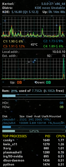

        Right, but wouldn't something like this give you an even better picture of the overall state?
