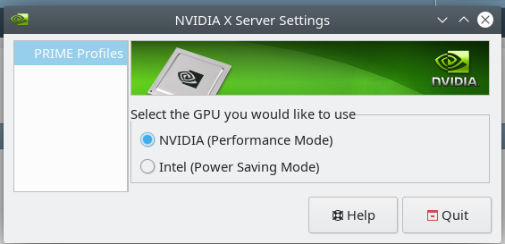

Currently nvidia-settings shows a very "empty looking" window.
There used to be many more options to see.
