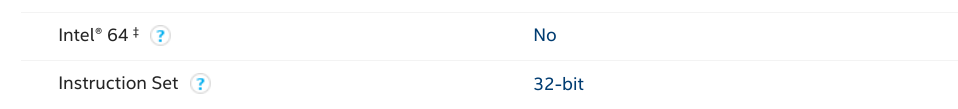

                The Linux operating system that came with this is 64bit. I suspect it can run 64bit fine as long as a light wm is used. This thing has over 20 Gigs of HD storage but if I remember a slightly slow GPU and not much RAM so a light wm and so forth is probably good else it will be a bit sluggish on the desktop.
                Your cpu is definitely not 64 bit
                https://ark.intel.com/content/www/us...3-mhz-fsb.html
