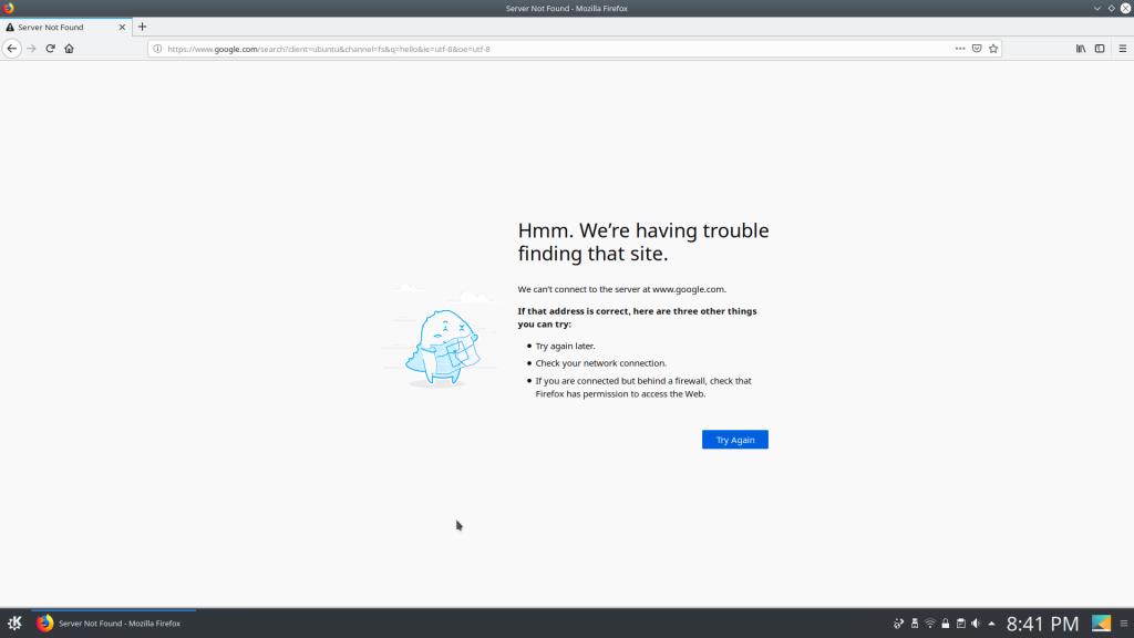

      The installation is just brand new I did not install anything, I have done updates, sometimes it works sometimes some daemons crash. I believe I have only done OS update once. My wifi adpater is D-Link DWA-125. Everytime I open up firefox this issue happens, I have tried restarting my PC many times, still doesn't make a difference. I do get a message from the browser and I will attach two images which shows this.
      No browser extensions. I haven't installed anything other than doing updates and this was even happening before updating. I don't believe Kubuntu comes with any configured firewall that should be blocking any of this.

          I have tried doing that and it did load up google and it went to the firejail site, but it could not load up the brave browser website "https://brave.com/" until I disconnected it and reconnected it to the original female usb port.
          When I tried to load the download page, then it would show the same error message but after reconnecting it in the same USB female port then it works and I seem to be having to do this for any new page I want to load.
