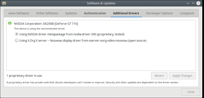

    I installed it via "software and updates".

      Software and updates, it's in the repositories, easiest way I know to deal with drivers, it looks like this:
