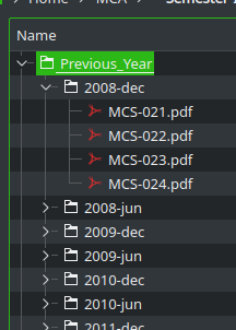

    Okay so, I have a folder structure given below.
    What I want to do is append "2008-dec" to "MCS-021.pdf" so it should become "2008-dec_MCS-021.pdf" and so on for the rest of the file. Then this should repeat for the next folder "2008-jun"
    I have these files in all the folders the name is same only the folder name is different.

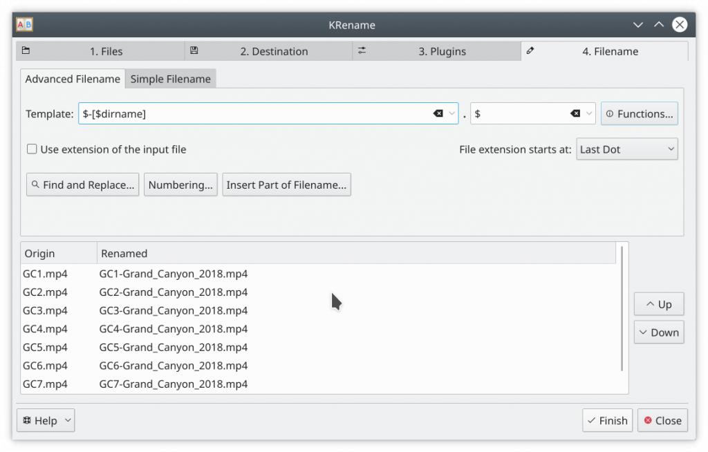

        We forget the powerful and cool GUI tool with the old KDE 3 era let's-tack-a-K-on-every-app name: Krename
        it will do exactly this
        You do need to do some tweaking to make it fit your needs.
        The '$' represents the original file name, so you can move that to the end of you like, and insert a dash as I have, or spaces, underscores, whatever you like.

          Well, there you go, it looks like you will
          Very nice utility that.

            Krename ,,,,yes I remember that now .
            it seams that once installed (sudo apt install krename) it is integrated into both Dolphin and Krusader (if you happen to have that) in Dolphin it will be found in rite click>actions .
            if one say "ctrl+a" a bunch of files then "right click>actions>rename with krename" the hole set will be loaded in the Krename window that will open.

              I found "krename" interesting. Let me try it out for a couple of days if I face any problem I may reply again. Like always I got the solution to a problem which is difficult to tackle in other commercial OS. Thanks everyone.
