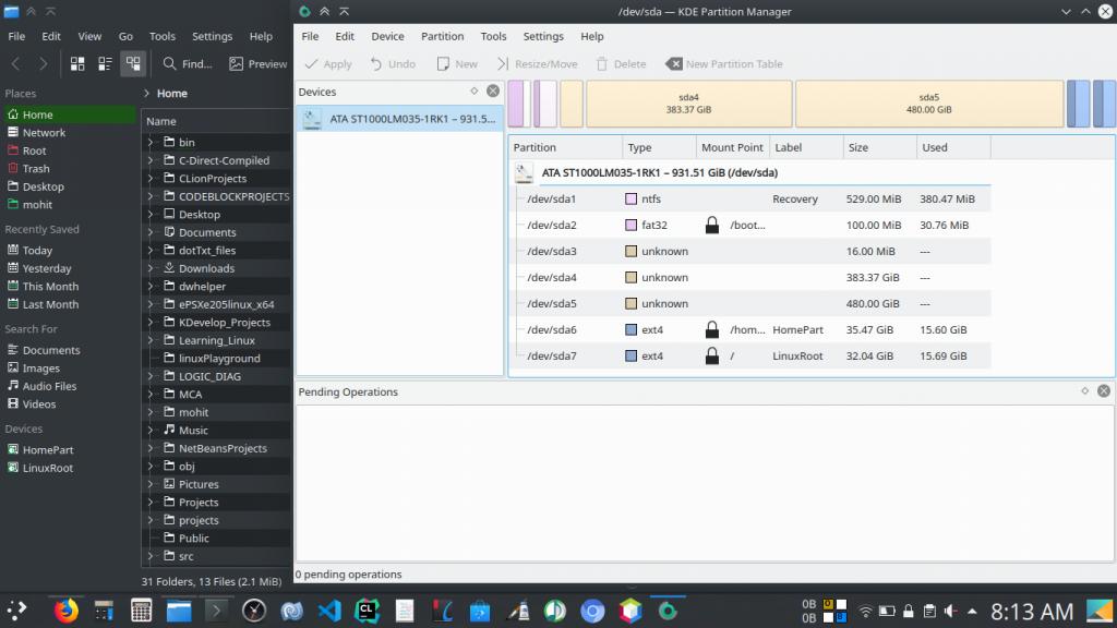

    However, what the problem is neither of my C and D drives is visible to my existing Linux system. In KDE Partition manager it shows both the partition with unknown type filesystem.

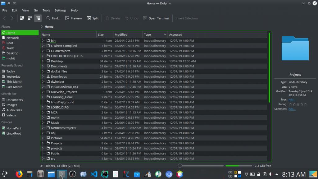

    I forgot to attach the screenshot of the KDE partition manager and my dolphin. Please have a look.
    ThanksClick image for larger version
ID:	644241Click image for larger version
      Only the HomePart and LinuxRoot are available under Devices section.
      (HomePart is my home directory which is on a separate partition and LinuxRoot is the root partition)
