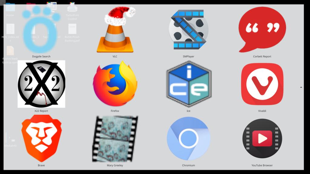

                              Creating a Full-screen Launcher
                              Admittedly makeshift - but functional, for now.
                              Add the Quicklaunch launcher widget to your desktop. Drag it to the upper-right hand corner. Extend the lower-left hand border to make the launcher fill, perhaps 2/3 of the desktop. I size mine so I don't have drag the links from the system menu very far. Open the system menu/launcher to the Internet category and drag one of the SSB links and drop it on the Quicklaunch. The icon will be very large but they will get smaller as they share with additional icons. Now would be a good time to configure Quicklaunch to have 3 rows. Also tick boxes to Show launcher names and Enable popup. Leave Show title unchecked. Click OK.
                              Start adding more SSB shortcuts to the Quicklaunch. As a proof of concept I simply added my first shortcut to the Quicklaunch 12 times. 12 seems to me to be the optimum size for the Quicklaunch launcher. Close the system menu. Drag the lower-left corner SLOWLY until it fills perhaps 95 percent of the desktop. On my little underpowered rig the Quicklaunch will crash to the menu bar if I drag it too fast.
                              Note: if you used YouTube shortcut favicons they will look pixilated. Most other websites don't do this. Using a better icon solves this problem.
                              This works, but it is not ideal. Do you have suggestions for a better launcher?
                              -=Ken=-
                              Screenshot of full screen Quicklauncher with 12 icons (not all SSB). I think you could add a 4th row and then get 16 or 20 icons which can be seen from the couch.

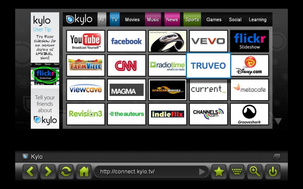

                                Meanwhile, while I am waiting for my GT730 video card, a second 4 GB DDR3 RAM stick and a USB WIFI dongle to arrive from eBay to boost my underpowered SFFPC I will explore the Kylo TV browser and some possible alternatives.
                                http://tv-true.org/platforms/kylo-browser-review.html Here is a screen shot (1 of 8) from that website:
                                It has the navigation bar at the bottom. Interesting, and different, but users say it is quite natural using a TV that is usually mounted somewhat above normal eye level. Check the link because it has an on-screen keyboard and the large controls that lend themselves to TV on the couch. One of the screenshots shows a video search website named Truveo but, wouldn't you know, it no longer exists, at least in a form we could use. This TV browser is still available for M$ Windows but uses some old and obsolete tech to make it work. Apparently, it never worked properly on a Mac and no mention of Linux.

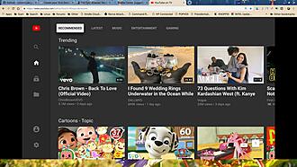

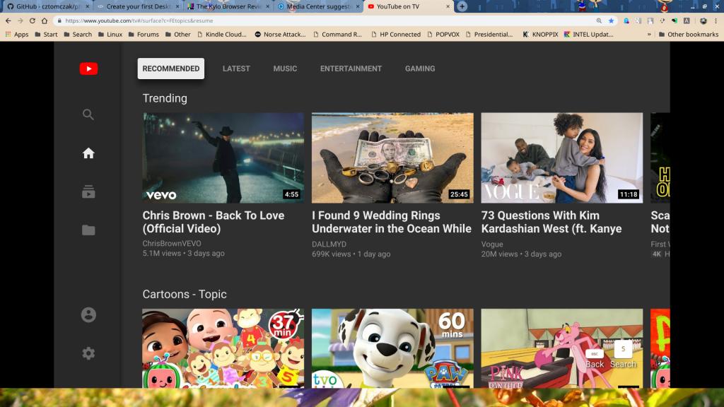

                                One interesting TV interface works for YouTube only. It's called YouTube Leanback. I'm surprised it isn't mentioned more.
                                http://www.youtube.com/leanback screen shot (Note: I had trouble getting a borderless screen shot)
                                It works very much like the Roku app including the "woot" sound it makes every time you use the arrow keys to navigate.
