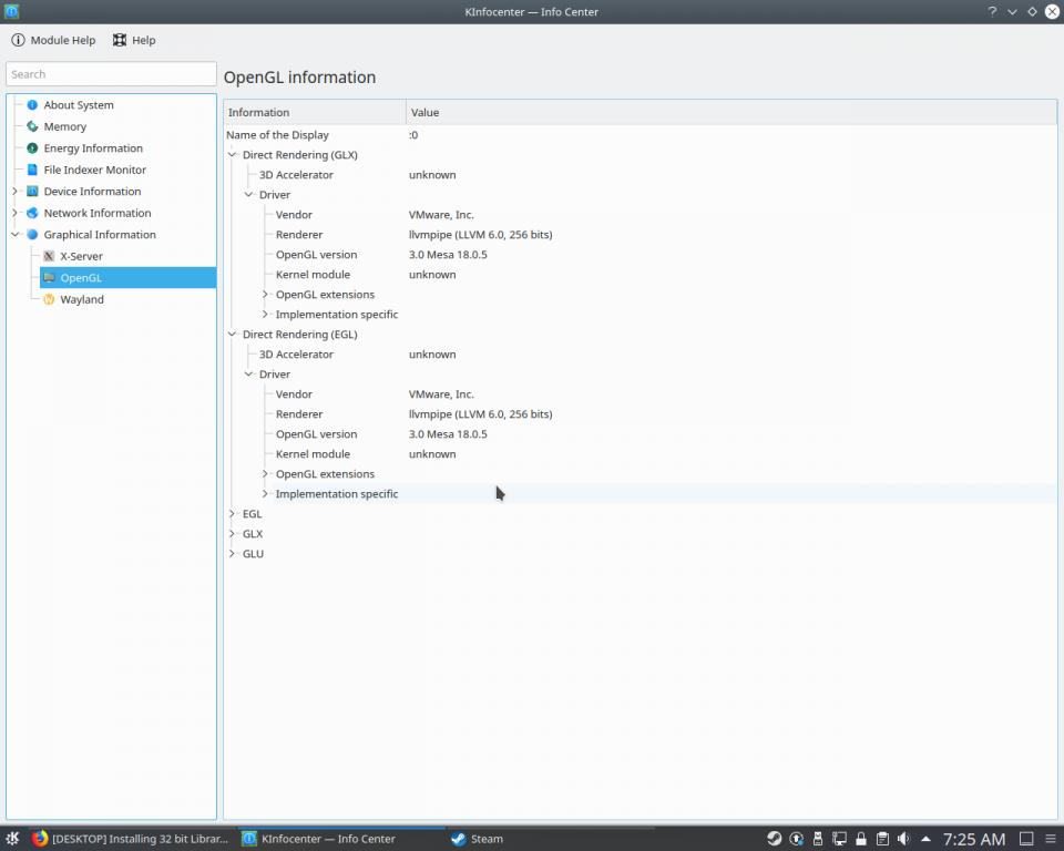

My resolution is now 1080 X 1024, NVIDIA-configuration tool does not work and there is No 3d acceleration! Let's see what kinfocenter says:
VMware?? I don't have VMware installed! What happened to NVIDIA?
I wish there was a way to list apt history so I could see what happened.
I remembered I could press up arrow to see if I misstyped any thing:
Code:steve7233@steve7233-desktop:~$ sudo apt --purge remove nvidia* && sudo apt install nvidia-driver-396
Last edited by steve7233; Oct 12, 2018, 08:00 AM.Just to remind users and devs that Ubuntu and its flavors have a long way to go to be as usr friendly as they should be.
