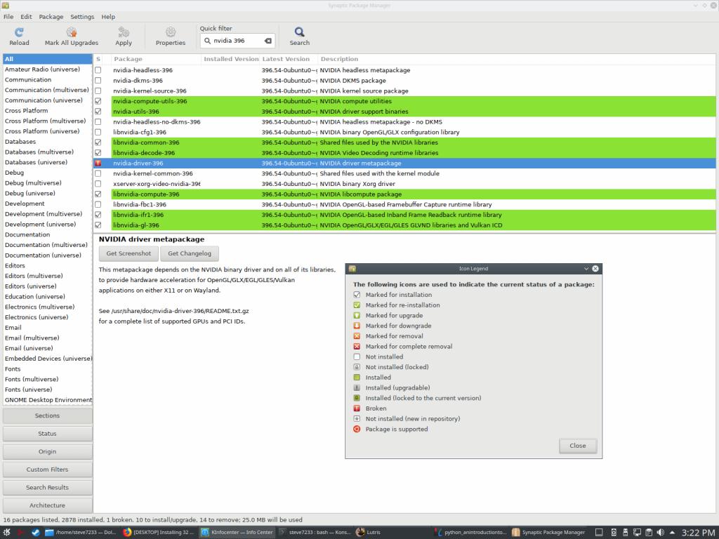

This is a desktop and the NVIDIA is on a daughter card. The motherboard does have video but I disabled that in the BIOS. I used Kifocenter Device Information>PCI and it looks like the onboard video is Intel. Since it is disabled in the BIOS config then it shouldn't matter right?Last edited by steve7233; Sep 21, 2018, 04:12 PM.Just to remind users and devs that Ubuntu and its flavors have a long way to go to be as usr friendly as they should be.
- Top
- Bottom
I have no idea where you are getting a package named "nvidia-driver-396" from ,,,I can not find it @hear
if you search "nvidia-396" what do you get ,,,,that is what I suggested you install , from the command line , with apt-get ,,,,,
if you doCode:sudo apt-get -s install nvidia-396
EDIT: hold on let me check in the bionic install,,,thay do have a package named that in the bionic section .

you are correct the meta package (that depends on all the others you need ) is called "nvidia-driver-396" in bionic .
and it is strangely broken ,I will try to let them know .
why it was changed from "nvidia-396" in xenial to nvidia-driver-396 in bionic I am not sure ,,,,,the "nvidia-390" is still the same .
