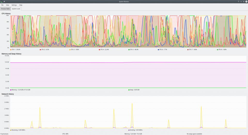

    I'm having some performance issues that I'm not sure what the cause is.
    Even when the system is ideling, the CPU is usage is high. can't find the origin of the issue though from system monitor. When I go t the processes tab -> all processes -> sort by CPU usage, it shows some process using soething like 3% and nothing else. The rest of the system experiences freezes all the time, in which I can't do anything and the sccreen doesn't update, then it returns to normal before freezing few seconds later.
    I'm not sure of the cause of this behaviour or how to diagnose a particular cause. I supect a kernal update (I did go though a few kernal updates), but I'm not sure. Also, when the system is lagging like this, the keyboard mistypes chiaracters occasionally It might just throw random character that I didn't type into the sentance for some reason.
    System monitor during idle:

      My first thought when I see something like this is the baloo indexing gone wild. Baloo indexing can be disabled by
      balooctl disable
      followed by a reboot.
      More info here, which included how to set ballorc to shut off indexing
      The fact that the processes tab shows nothing going over 3% is odd. It suggests that something is running but concealing its presence from the process id list. I noticed in your list of directories that you have one labled ELYSIUM. Is that related to a Steam game or to bitcoins? Do you have a bitcoin miner running in the background?
        @GreyGeek After disabling balooctl, the issue stopped and CPU usage has returned to normal.
        Does this mean that I'll lose indexing for search though? Is there any way to resolve this without losing indexing? (Like resetting a cache or something to stop it from freaking out?)
