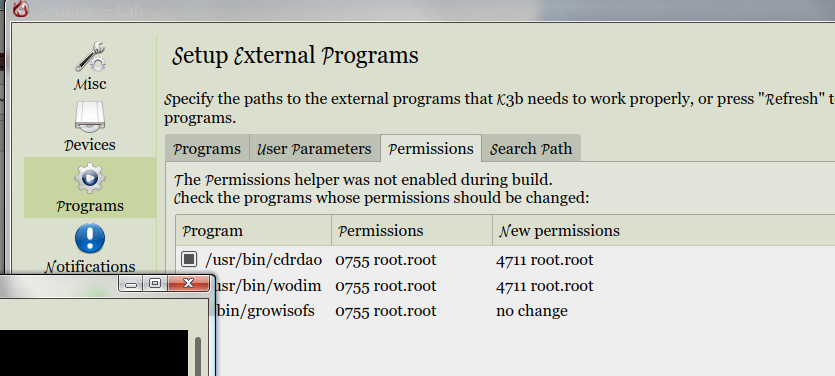

GG, your hint helped but took me a while to search for what really needed done.
So, K3B can't modify those permissions through it's settings interface thought it does show what it wants under New Permissions. See screenshot below. Had to go to Konsole to manually change to what they needed to be. That is below the screenshot. I did a pre-list of permissions just to be sure what I did worked and also to have a reference point to go back if I screwed it up. Working now so I guess it did work.
Hope this helps others.
moonrise@PANTHER:~$ ls -la /usr/bin/cdrdao -rwxr-xr-x 1 root root 665832 Jan 14 05:17 /usr/bin/cdrdao moonrise@PANTHER:~$ sudo chmod 4711 /usr/bin/cdrdao moonrise@PANTHER:~$ ls -la /usr/bin/cdrdao -rws--x--x 1 root root 665832 Jan 14 05:17 /usr/bin/cdrdao moonrise@PANTHER:~$ ls -la /usr/bin/wodim -rwxr-xr-x 1 root root 454376 Apr 21 2017 /usr/bin/wodim moonrise@PANTHER:~$ sudo chmod 4711 /usr/bin/wodim moonrise@PANTHER:~$ ls -la /usr/bin/wodim -rws--x--x 1 root root 454376 Apr 21 2017 /usr/bin/wodim
