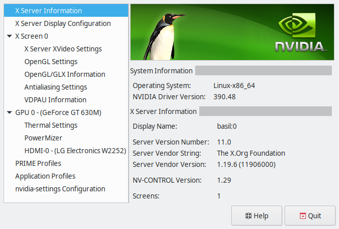

          I have just removed the graphics-drivers/ppa and purged all nvidia* from my system as well as all other nvidia related packages including those listed in Muon. So nothing related to Nvidia was left in my system.
          I then installed Nvidia-390.48 using the Bionic repositories and it is now working, ie I get:
          So it now looks like the graphics-drivers/ppa is the culprit. I just hope that the problems with the graphics-drivers/ppa can be fixed. I will wait a fair while before I check this again.
          Thanks very much to you all for being so helpful with this problem and also to oshunluvr for providing the solution.
