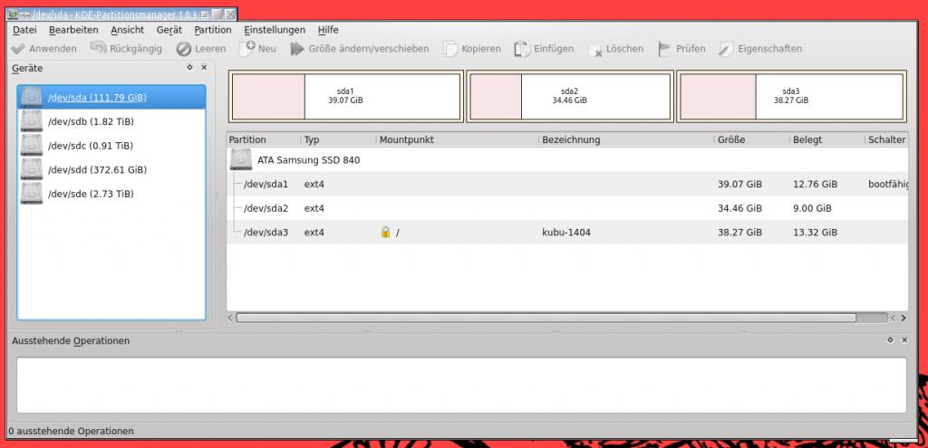

        Hello
        I have made a sceeny of my /def/ containing my three OS partitions. Would it be a good idea to delete /dev/sda1 and sda2 and running several partitioning runs?
        What I don't understand is the identical fault on both dev's as they are totally different OS. And there should not be a connection to both. But neverthless, the identical fault exists on both.
        Would It be OK to delete both partitions (1 and 2) and then make a new partition and install a non-plasma distribution? Once done successfully (read I get an OS running) I could redownload the 18.04 and the 19.14 one after the other. Before that I would delete the downloaded installation files.
        If you find this is worth to do, can you suggest a small OS outside the Buntu world?

          About whether "Would It be OK to delete both partitions (1 and 2)"... me, I find it a bit of a funny question. If anyone knows that, it's you.
          Still, you would only need one to install one OS.
