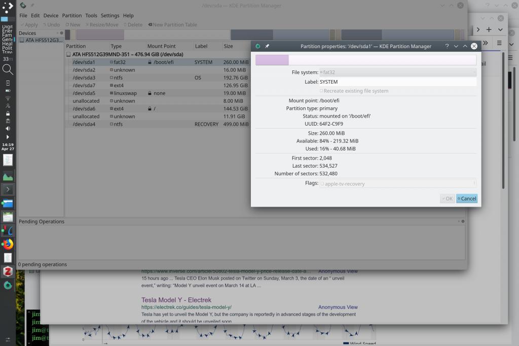

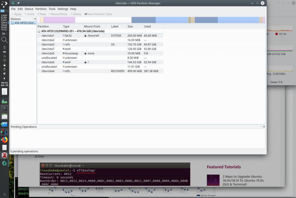

    I will attempt inserting the partition table and properties of the EFI partition pngs
    But I expect that I don't know how, so I can supply them by email if I fail.
    file:///home/jim/Documents/T3P efi UUID 64F2-C9F9.png
    file:///home/jim/Documents/T3P partition table Screenshot_20190428_085516.png

                          done
                          Processing triggers for shim-signed (1.37~18.04.3+15+1533136590.3beb971-0ubuntu1) ...
                          Secure Boot not enabled on this system.
                          root@kubuntu:/#
