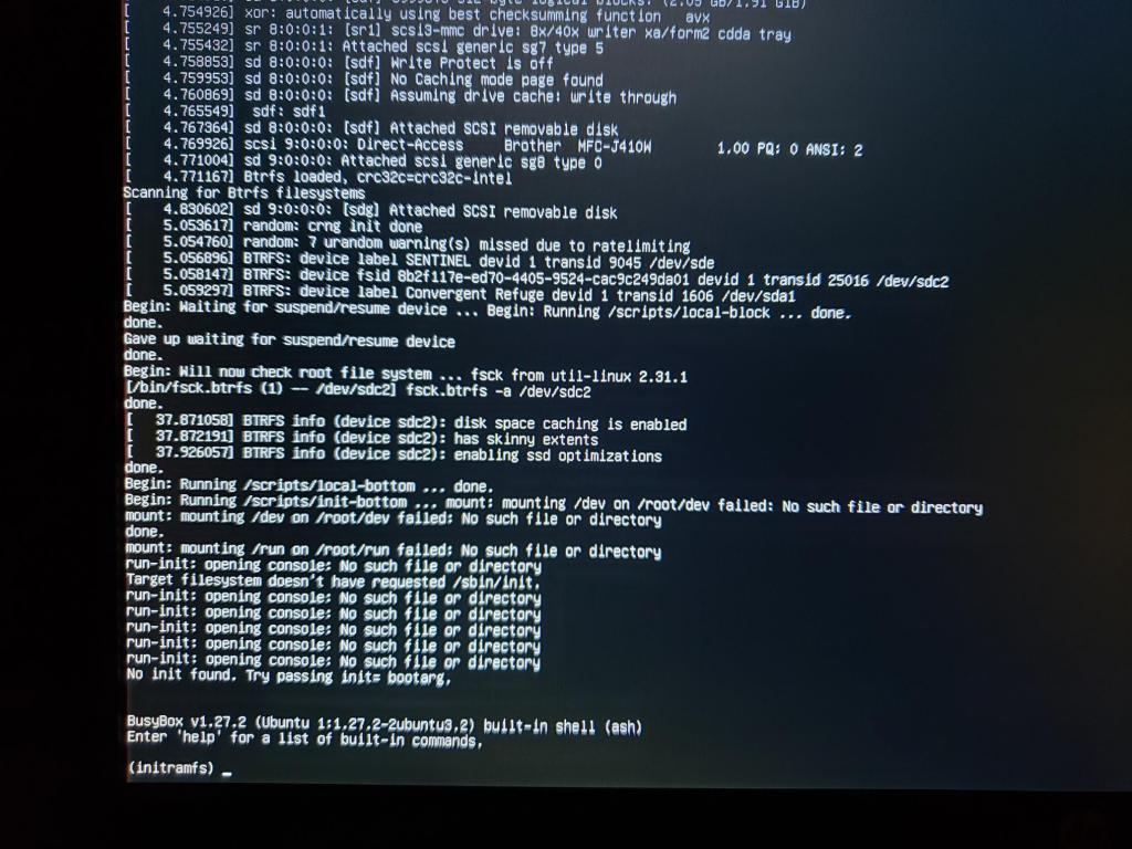

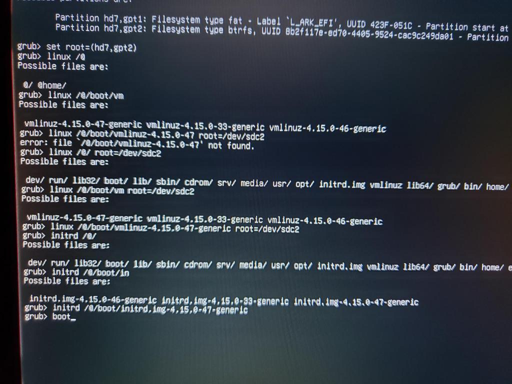

I can't get grub to boot it though. I even tried to boot from the grub command line using typical methods, but got stuck when the system mostly booted but I got an additional terminal saying that init wasn't found and I didn't know what to do from there.

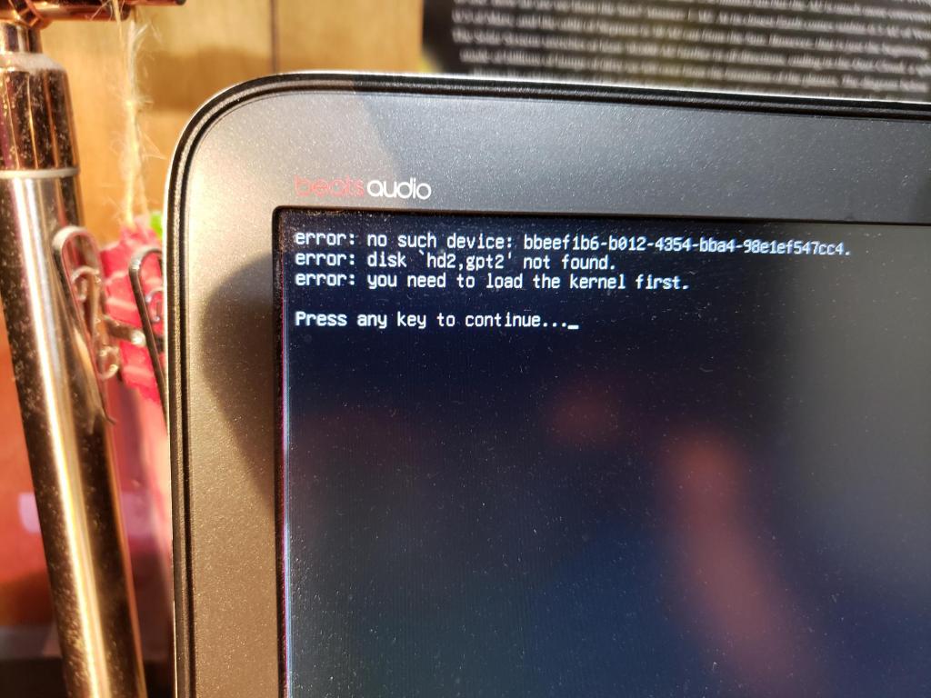

This is the screen when I choose default options in grub:
EDIT 1: There is also this error:

I found out that the UUID of the hard drive had changed since I did the install of 19.04, so I changed this in /sdc2/@/etc/fstab. Strangely, at boot time in grub, it still shows the old UUID in the error prompt. I figured that maybe it was going off an old fstab, so I deleted the boot entries using efibootmgr and then did the grub-install process using --boot-directory and --efidirectory parameters.
Grub-install went fine with no errors, but it still produced the same error at boot time. Still not sure what is up with it. Can't manually boot either.
Here are some pictures of what's happening:
(Manual Boot)
(Results of manual boot)
