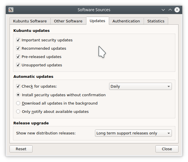

                I see (in Muon) that plasma-discover is installed. Is that the package to un-install? And after doing so, will Muon continue to offer updates through the update icon in the system tray?

                  Works for me.

                    OK, I removed plasma-discover, and have Check for Updates marked in Muon Settings, and I'll test this to see if I get update notifications in the system tray. Thanks.
