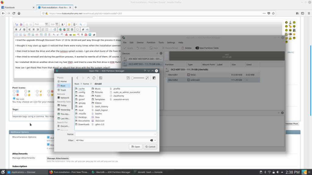

    So I installed 18.04 on another drive (not my fast SSD), and tried to view the first drive in KDE Partition Manager. I can see the drive, but it shows it as an unknown file system (LVM). I can 'restore' to see the folders, but not the files.
    How can I get these files from that drive? or rebuild that drive with the file system intact?

        Yes. I can see the partition, as you see on the screenshot. I can also see all of the folders.
        I don't remember giving any commands at all to the upgrade. It just showed that it was 'upgrading ubuntu 17.10 to version 18.04 and that it didn't need a number of installed packages. Then it ran for a while and quit.
        The SSD drive is only a couple of years old, and when I ran a check, it didn't show any problems. Partition Manager shows that it is unformatted and that its Mount Point (none found). When I select Restore, I can see the folders but no data in them...
