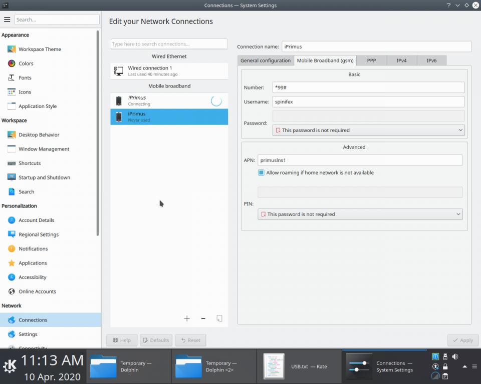

                Then go to system settings, and then Network >. Connections, then click the '+' to add a new connection, then click the Mobile Broadband option, to follow the wizard.
                Thank you - that worked fine as regards setting up but at the end failed to connect. If I can I will attach a graphic. Notice that thin blue crescent - that circled for several minutes but no more happened.

                and on the other side : PENDOClick image for larger version
Name:	Iprimus screen.jpg
