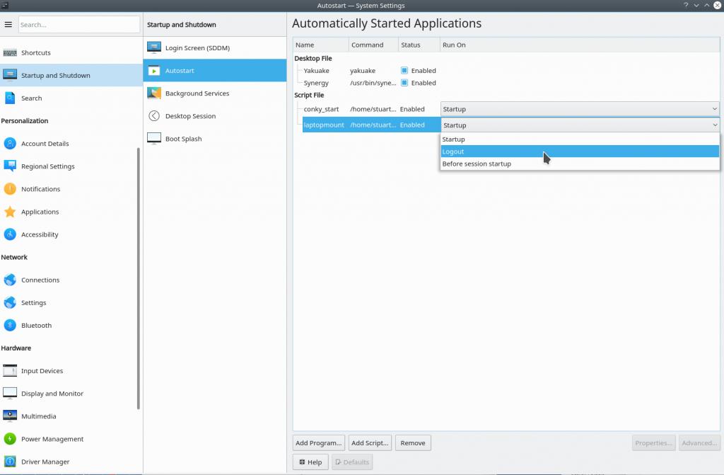

            Create these scripts somewhere, make them executable, and add them to your log-on and log-off scripts in System Settings.

                As oshunluvr stated: "...add them to your log-on and log-off scripts in System Settings."

                    It works well, thank you Snowhog. For my own edification, I'd like to better understand the scripts and relationship to the nfs line in my fstab. First of all, both scripts are still dependent on the nfs line in my fstab, correct? In other words, they won't work if I comment-out the nfs line. I read the ping help file and learned that -c is a count option, so -c1 outputs a single ping which is all that's necessary to determine if the server is up or down. -w is for deadline, but eliminating it from the ping command doesn't seem to make a difference nor does incrementing sequentially up to -w5. What is the purpose of the -w option then?
                    I also see from your screenshot, that you start Conky in the autostart section; nice. The last question I have, is what is the gui actually doing? Where in the OS is it actually running the symlinks it created, or what init or systemd file is it using to call those links? If I'm going to learn Kubunu, I need to know what's happening behind the scenes. Thanks again to all who replied.

                      As far as the GUI and the scripts, when you enter a script or program into the GUI, it copies the desktop file (for a program) into ~/.config/autostart and any scripts into ~/.config/autostart-scripts.
