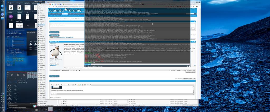

    I have set my Konsole up this way on my 38" wide screen (single monitor). I have Konsole "stuck" to the right side of the screen with a transparent background.

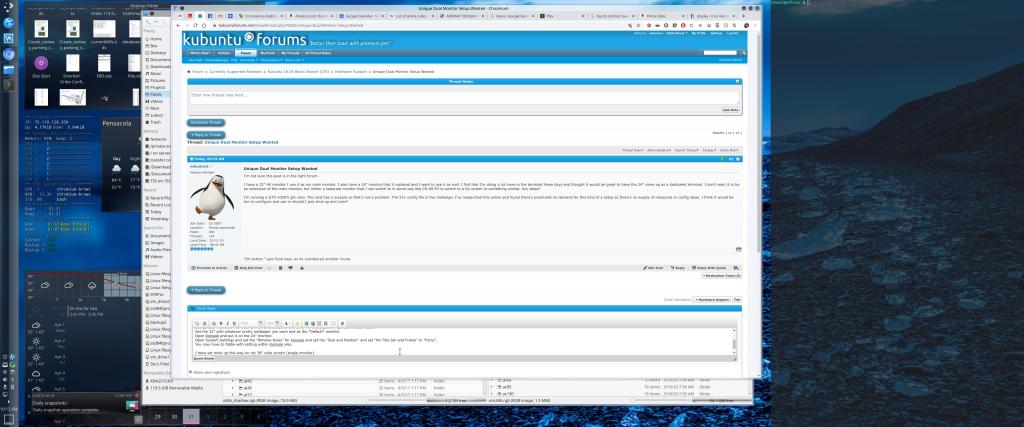

    Alternately, you can ditch the 24" and use Yakuake terminal like this:
    It drops down from whatever location you choose.
    As you can see I have both options available when I need terminal time (every day).

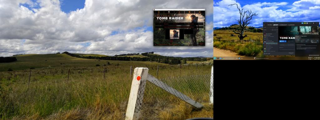

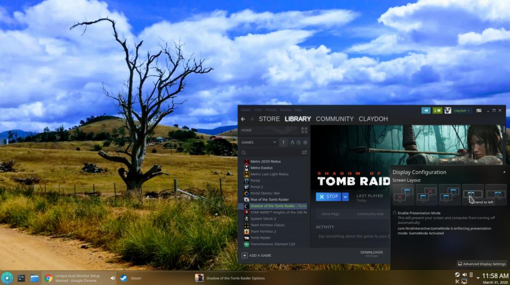

      I do something similar, with a 24 inch monitor as the main screen, and my 40" TV as a secondary screen, turned on when needed via the Monitor config systray icon. I primarily use it for gaming., but the setup does work well for viewing documents while working
      Ya, I shoulda taken separate screenshots...
        This is a bit better
