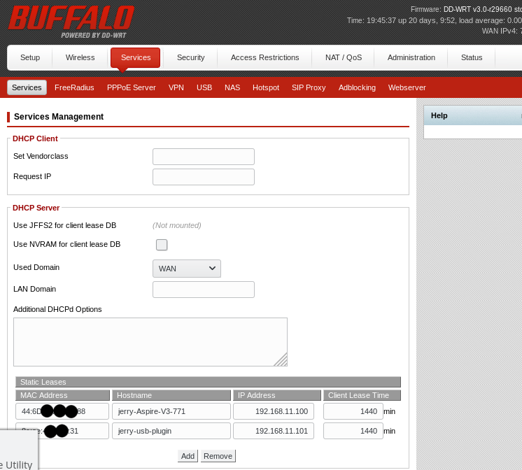

                    When you attach it via a router's Ethernet port or by a wireless router then configuration is up to you. This you probably already know. Either way, the router's DHCP assigns the IP address and CUPS handles the printer driver. (If you plug it into an Ethernet port on your laptop you'll have to run dhcpd and configure it yourself.)
                    You can access the CUPS help file on IPP by browsing to:
                    http://127.0.0.1:631/help/network.html#IPP
                    The router's base address varies by manufacturer, but it is always in one of the three reserve areas:
                    What IP Addresses Are Private? (I.E., are not visible from the Internet side of the router)
                    The Internet Assigned Numbers Authority (IANA) reserves the following IP address blocks for use as private IP addresses:
                    • 10.0.0.0 to 10.255.255.255
                    • 172.16.0.0 to 172.31.255.255
                    • 192.168.0.0 to 192.168.255.255
                    The first set of IP addresses from above allow for over 16 million addresses, the second for over 1 million, and over 65,000 for the last range.
                    The router DHCP firmware assigns an IP address to any device attached to it based on rules set up in the router by the user. Default rules are used if the user does not modify the factory settings. Usually the rule is to start dispensing IP addresses starting with, for example, 192.168.1.100 Routers vary as to their gateway address, which is the first three of the quad address. It is first come, first served. Say you plug your printer into a USB port. Both it and your computer are on. CUPS sees it, reads its firmware and established a USB connection. For printers connected to a router via an Ethernet cable or by wireless you browse to http://127.0.0.1:631 and click on "Adding Printers and Classes". On the next page you can click either "Add Printers" or "Finding New Printers".
                    During the setup you can assign an IP address one or more less than the beginning IP address the router assigns. In my case, that would be 192.168.11.99 were I setting up a network printer. Since that is below the starting address for the router's DHCP to start dispensing IP addresses is 192.168.11.100, the DHCP will never conflict with the printer's assigned address.
                    When setting up your router for a MAC address control of the dispensed IP address you have to enter the section of the router's HTML firmware that allows such configurations and assign your MAC address to the IP address you want the DHCP to dispense. Here is my setup for my laptop:
                    Once you set it you save it and reboot your router to create the connection. You can usually query your printer control panel to find out what its MAC address is. If you issue

                      After a bit of reading and work I got a unique IP address assigned to my printer through my TP-Link router.
