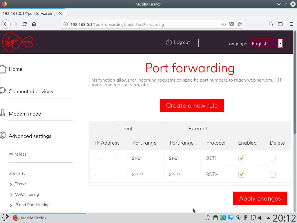

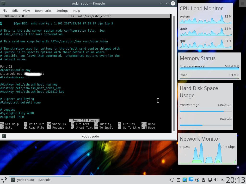

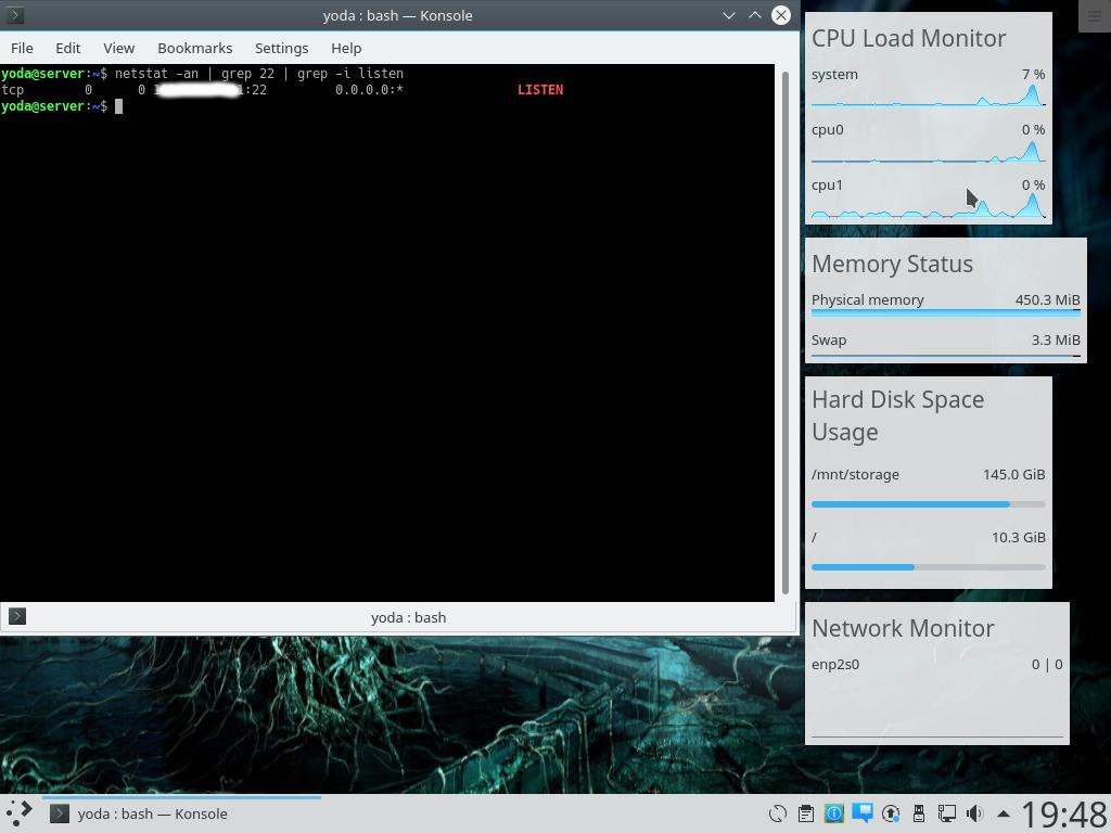

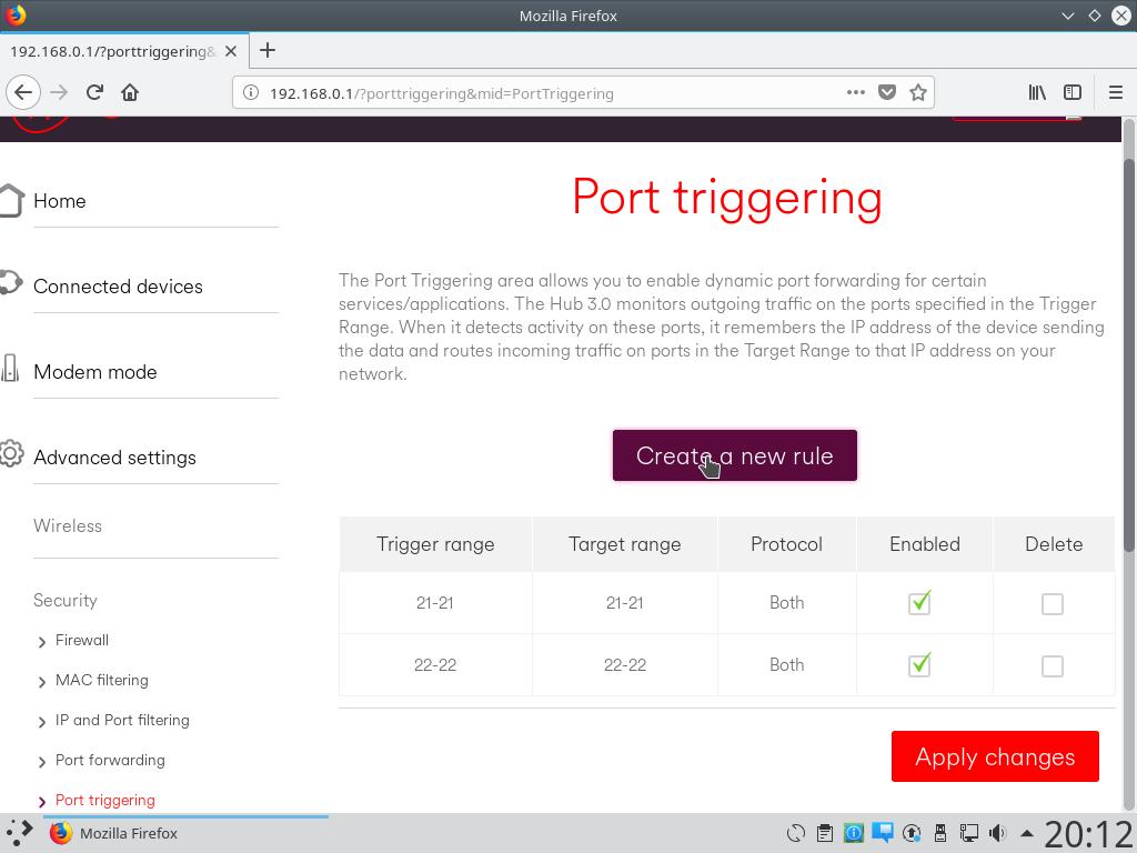

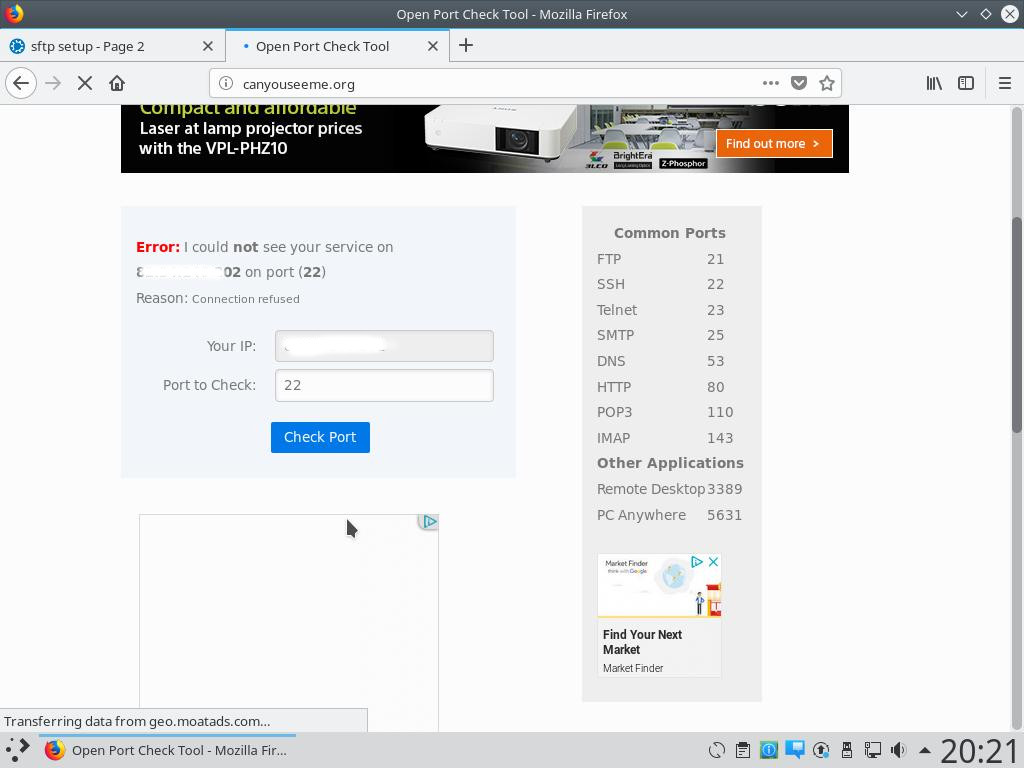

Ive installed the 64 bit OS Kubuntu 17.10.1 i felt more comfortable with it for now everything is set up i just have this nagging port problem to deal with Ive taken screen shots showing how things are set up Ive removed my actual ip address from them can you see any reason for why i cant seem to get this working?
Dont edit the listening address. Be sure you can connect to ssh via the machines local address , remember to restart sshd after anychanges to the sshd configuration
You should not need to make any changes in the ssh configuration itself. the only change should be to done in the router and this should foward the port from your comptuers ip at port 22 to your external ip on NOT port 22.

hi all sorry about the long delay after talking with my isp it was made clear to me i have to put my virgin hub into media mode and use a second router, i was just wondering i found my old isp's router its a huawei do you think it will work ?

Most ISP's won't let the customer edit the router's configuration. You should be able to connect your PC to the Virgin hub with an ethernet cable, but does it transmit a wifi signal as well? If you add your own router you should ask them to turn off the wifi in their hub so that your router can offer it AND you can edit the wifi configuration (by browsing to the router IP address, which is usually 192.168.1.1 -- check the manual) and set port forwarding in it. THAT's why I either burn DD-WRT into my router's firmware, or I buy a router that pre-installs DD-WRT, like the Buffalo 600N that I am presently using. BTW, a good wifi router will let you transmit on both 2.4GHz and 5 GHz at the same time.

aye the virgin hub has to go into modem mode turning it into a modem and ill have to buy a new router
