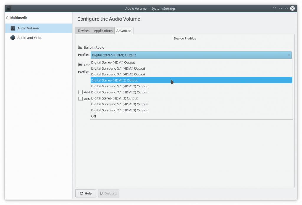

                      if you click the speeker icon in the system tray do you see "something" like this ,,,,,,,,,,,,,,,,,,,,,,,,,,,,,,,,,,,,,,,
                      if so , wile playing audio click the "applications tab" and drag and drop the app playing audio and drop it on the HDMI device ,,,,you should now get sound .
                      if you do not see a HDMI device ,,,then their is more work to do to discover why.
                      this ,,,,
                      pactl list sources
                      will list all devices that pulse audio is aware of .

                              so , your saying that you have audio through the HDMI , but turning down the built in speakers turns down the HDMI as well ?
                              in the volume control as shown in the screen shot ,do you have 2 entries 1 for the HDMI and one for the built in ?
                              post the output of the Konsole/terminal command I gave in post #25
                                #30
                                You may have to fiddle with different settings that you have available on your system. My Chromebook below does not have as many options as my laptop, which has many more selections, one of which put the audio to the hdmi only, but I can't recall which one. I am away from that keyboard for a while
