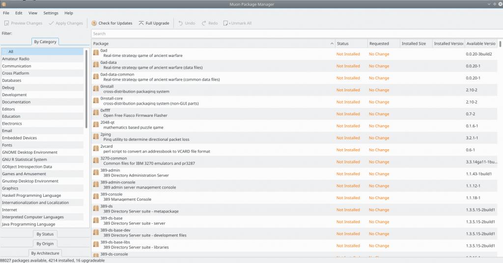

          Muon Discover was split out and is now called plasma-discover, the Muon package manager was un-maintained for a while and was broken, but recently received a bit of love and attention, you can install it:
          sudo apt install muon
          The screen shot below is Muon Package Manager running in Zesty
