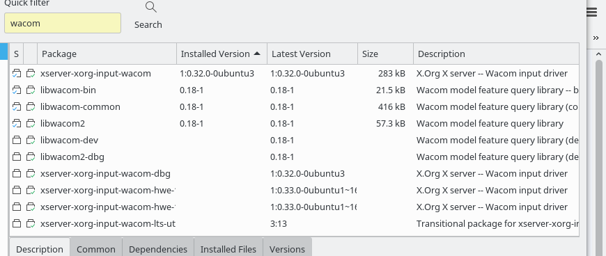

    I'm having trouble setting up my Wacom Pen&Touch tablet. In previous versions of Kubuntu, it showed up in the Input Devices section in System Settings, but not anymore. I have the wacom-system-tablet package installed and some other stuff that I don't remember right now.
    Does anybody know how to make the damn tablet show in the System Settings so I can remap the buttons or, at the very least, turn off the touch sensitivity?

    search the repository for "wacom" and make sure you have the three wacom apps installs, one being the video driver and the other two libraries.
      These are all the Wacom packages that Synaptic lists. You can see what I have installed (first column, blue tick).

      I think I have all that is needed... And as I said, the tablet used to be there before and is in fact working OK except that I can't tweak it...
